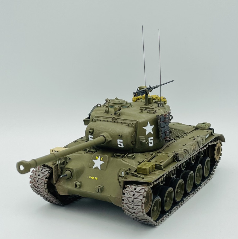

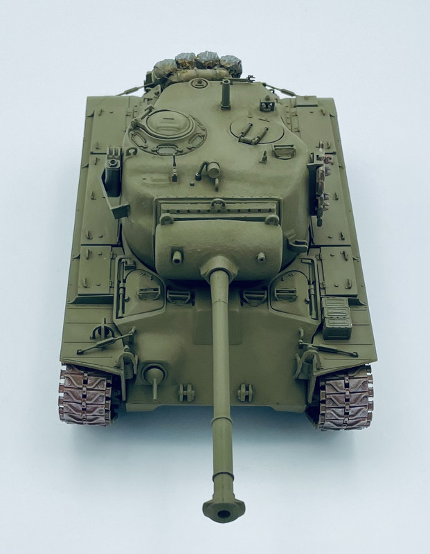

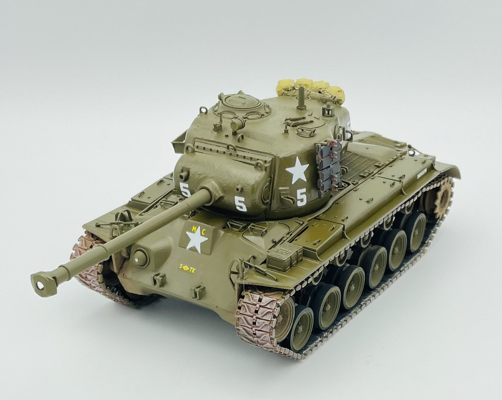

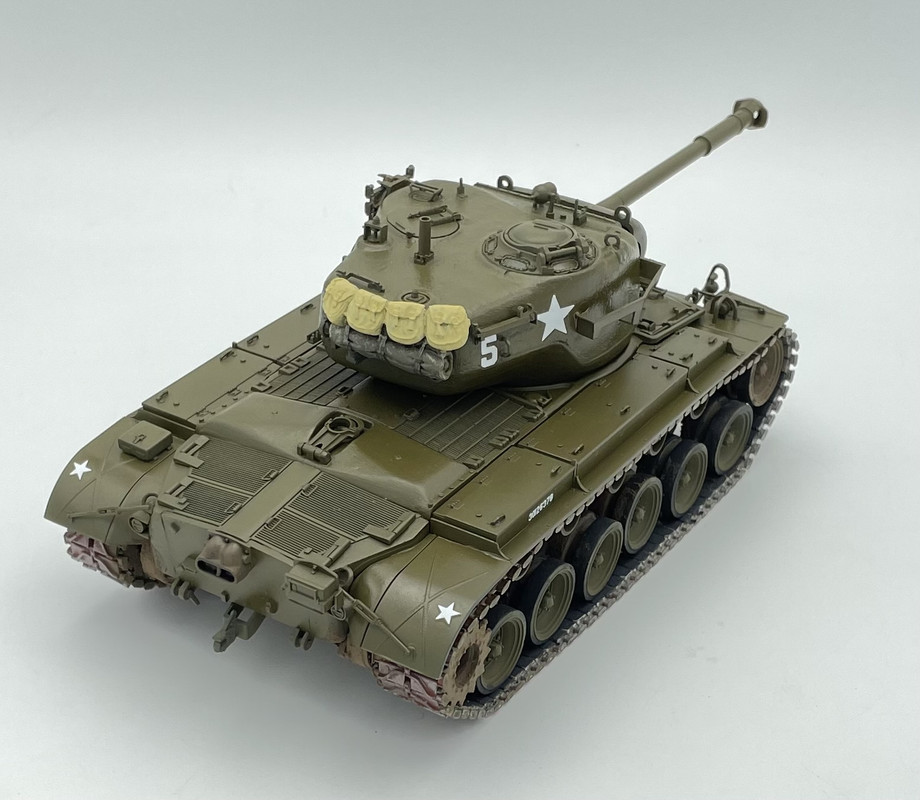

Stowage added, antennas added, most detail painting done….
just needs final weathering now….
