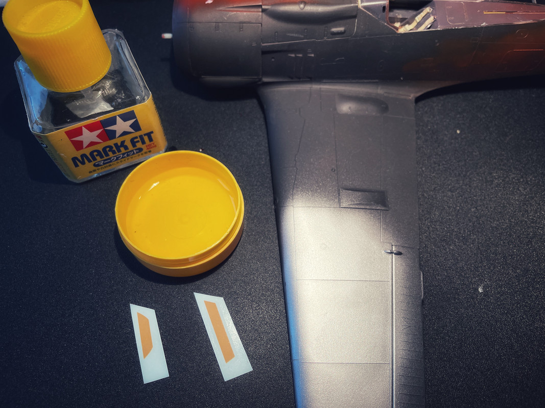

As I used this new type of decal on my Zero build (on the instrument panel), with great success and satisfaction, I cannot complain. But I thougt to make a very simple test to check how the decal setting solution might impact or not, the removal of the carrier film.
I use Tamiyas regular Mark Fit as the decal setting solution and 3 different alternatives:
a) DSS only under the decal
b) DSS only on top of the decal (as I did with the instrument panel decals)
c) no decal setting solution at all
And as said, the purpose of this simple experiment, is just to see if there is any difference regarding these 3 different alternatives. Of course, a fourth could have been added, decal setting solution under and on top.
As interesting note, the decal comes almost instantly off the backing paper when put in warm water, I mean almost instantly.
Now we just need patiently to wait a few hours to see what happens with the carrier film

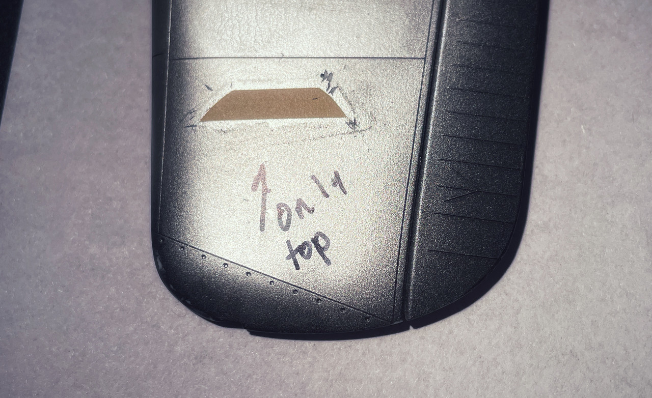

a) Decal setting solution on top of the decal:
First I was not even able grab the carrier film at all, even if it was visible. I tried with a very sharp scalpel knife, eventually scratching the surface pretty hard, forcing to get a grip of the carrier film and finally pull it off in one nice piece. But with the cost of destroyed paint and surface.
:hmm:
In the picture you can see the deep scratches caused by the scalpel, so based on this not a good idea to put decal setting solution on top of the decal. The leftover / shadow of the carrier film that is clearly visible in the picture could be rubbed easily off.

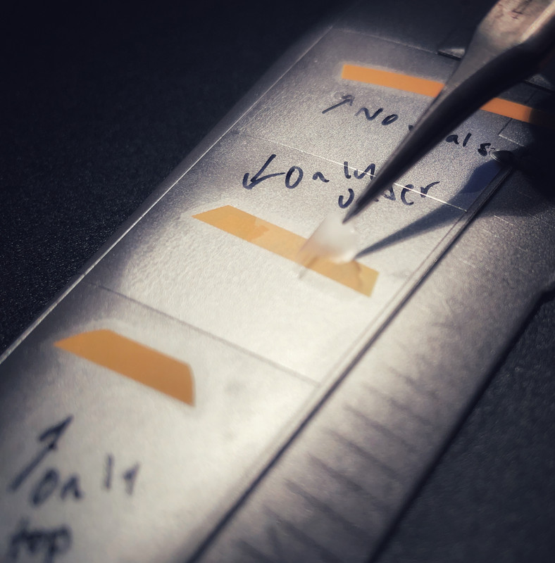

b) Decal setting solution under the decal:
To remove the carrier film was easier, I was able to grab the border of the carrier film by gently using my nail. But when I pulled off the carrier film it pulled as well a small piece of the decal! Which of course is not what should happen.
c) No decal setting solution:
As with decal a), I had some trouble to get a grab of the carrier film. I succeeded, but destroyed slightly the paint surface. On top of that, half of the decal broke and came off together with the carrier film.
Conclusion is, that I am not really convinced of both the new decals or the test. I will re-do the test, using other, milder decal setting solution and also add an option d) DSS on both sides. Will do the test on other surface, not on metallic color as in this current test.
