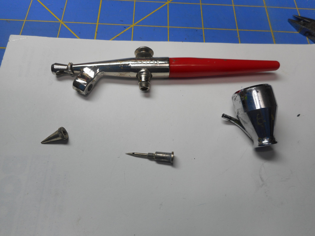

This is my Paasche airbrush. Short needle that's fixed by attachment on bottom angle slot. Nozzle cap goes in top under nozzle point. You have to place nozzle cap in first then push needle in and screw nozzle cap. cap is used for adjusting spray.
The paint cup goes into hole behind needle. It's an airbrush my grandparents gave me for my 15th birthday. So yeah, the airbrush is about 40 years old. I started using it about 4 years ago when I finally bought an air compressor.
Anyhow, I think I know what happened. I think the hole wain the top of the needle was plugged up from the last usage. BUT..... I still can't get a back flush in the paint cu no matter how I tried. Perhaps I have a small leak in my hose? I did manage to do a spray session though.

That is similar to my old Badger 350, but a bit nicer. Check your needle up against a strong light source. If you can see light thru it, no clog there. If no light, swab it using a pipe cleaner soaked in lacquer thinner.Next I’d say run a pipe cleaner thru the cup pipe. That is the second most likely place for a clog. Swab it using lacquer thinner for any clogging.
