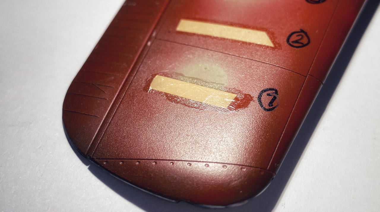

OK, a new test platform was applied yesterday.
For this test I used these different decal setting solutions
1) Mr. Mark Setter - Top
2) Mr. Mark Setter - Under
3) Mr. Mark Setter - Under and on Top
4) Mr. Mark Softener - Under and on Top
5) Daco Products Decal Setting Strong - Under and on Top
6) Tamiyas Mark Fit - Under and on Top
And here is how the look 24 hrs later. As seen clearly in the picture below, the carrier film that should be removed is more than visible.
The light reflection in the picture makes the carrier film almost disappear in the picture for nr 1 and 2. But in reality they are as bad as any other decal. As a matter of fact, nr 1 is worst of them all !
I will do the stress test this evening, but already now I start to doubt it will be successful.

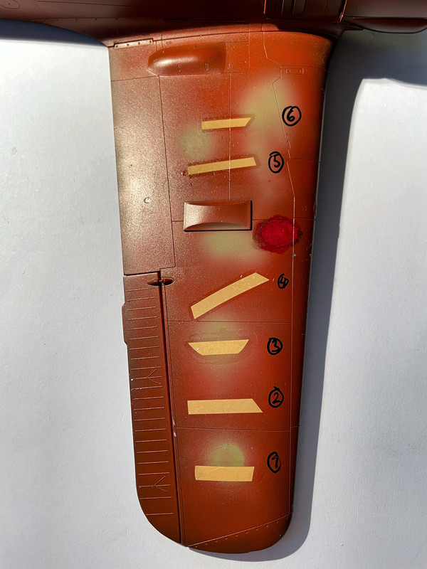

Then it could be, just could be, that Eduards decals would work better with a glossy surface ? The testbed used is very much flat and even slightly orange peeled ? Could that still have an impact ? To foresee this test, I shot a layer of Mission Models Glossy clear coat to make still one test.

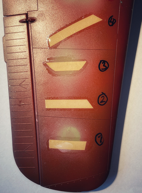

Eduards "new" Decals - RESULTS 2nd ROUND
Ok, the "result" of the 2nd test is here
Could hardly grab the carrier film, it was sort of "melted". I tryed with a moistured Qtip, with my nail etc, but the only way was to use a sharp tipped scalpel knife. Result, the carrier film came off and ripped 95% of the decal as well. The question is, does the decal actually have any glue on it ?? FAILED
After some initial struggle grabbing the carrier film, it came off in one piece, leaving the decal totally intact. Did not leave any marks of the carrier film on the surface. Result actually very good, giving some hope! SUCCESS
As with nr 1, the carrier film seemed to have melted, but after some more violent attack on the carrier film it came off. However, with some collateral damage to the paint. PLAUSIBLE
Difficult to say if I had luck or not, but one of the carrierfilms corners had rolled upwards, making it very easy to grab it and pull it off. And it came off easily. However, I made a "user error" and my tweezer touched the decal, scratching off a small piece. Lesson: Risk reducement: No sharp tweezers to be used! Also, leftovers of the carrierfilm still visible on the paint that I was not able to get off in a safe way SORT OF SUCCESS
Very difficult to grab the carrierfilm. First I thought it was a no go, but after a few scratches on the paint, the carrierfilm came off in a few pieces, but nevertheless it did come off. PLAUSIBLE
I included Tamiyas Mark Fit to this test, only because I had not tested this version, having decal setting solution on both sides. Well, it did not work better. I tried to use a piece of sprue, cut in a sharp angle, to carefully scratch the carrierfilm off. Was not that bad idea, worked pretty well and eventually the film came off. However, the carrierfilm leaves thick marks on the surface that don't look good. For me Tamiya Mark Fit is a No-Go FAILED
CONCLUSION
Winner in this 2nd round is nr 2: Mr Mark Setter under the decal.
Seems the carrier film gets messed up, when decal setting solution is added on top of it.
While it has it's charm, to finally have decals without that, sometimes annoying, carrierfilm, the difficulties in using this, without proper instructions (for tools, techniques, chemicals etc) is bad. It's too much struggling for something, that should be a relaxing moment to do.
And if one leaves the decals untouched, in other words the carrierfilm on, then the result is like stickers. Tamiyas decals are suddenly thin as gold leaf compared to these ones. There must be a fool proof way, I'm sure (I hope)
Therefore, a thumbs down from me until someone gives me the precise instructions how to succeed with a successrate of 100%.
And I start to doubt even more if I should order some AM decals for the Zero or take a chance and do my best with these Eduards ?
Will see soon, not many days left of 2021...
