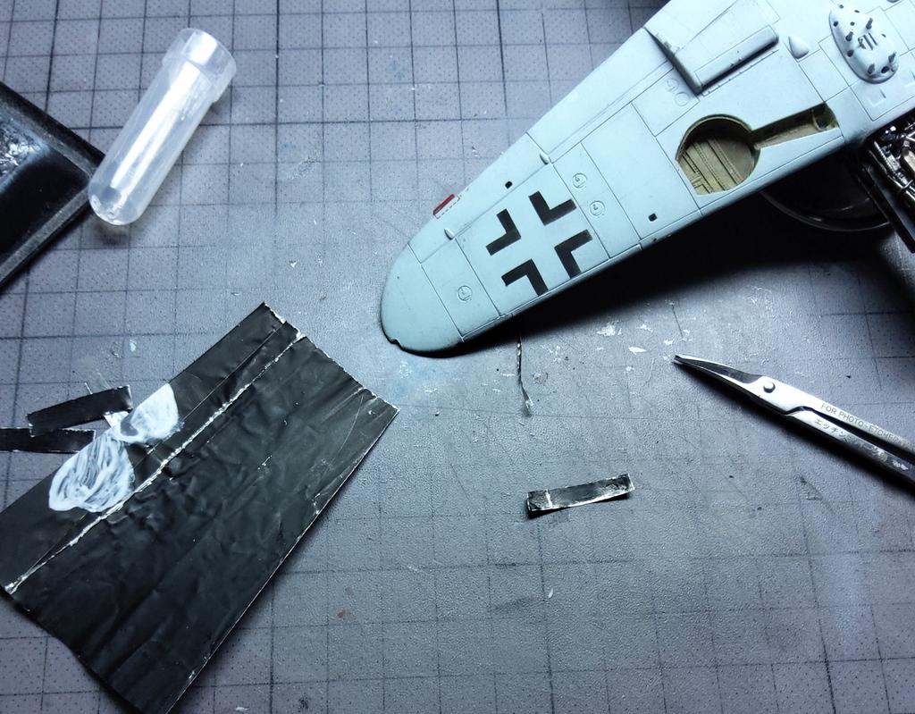

I can think of several quite simple ways to make the canvas covers simply slip in place. Thin styrene would be one method. Further details could be added with light scribing to suggest the stitches.
You could try a scrap of thin fabric wrapped around a styrene ring, perhaps.
Bruce

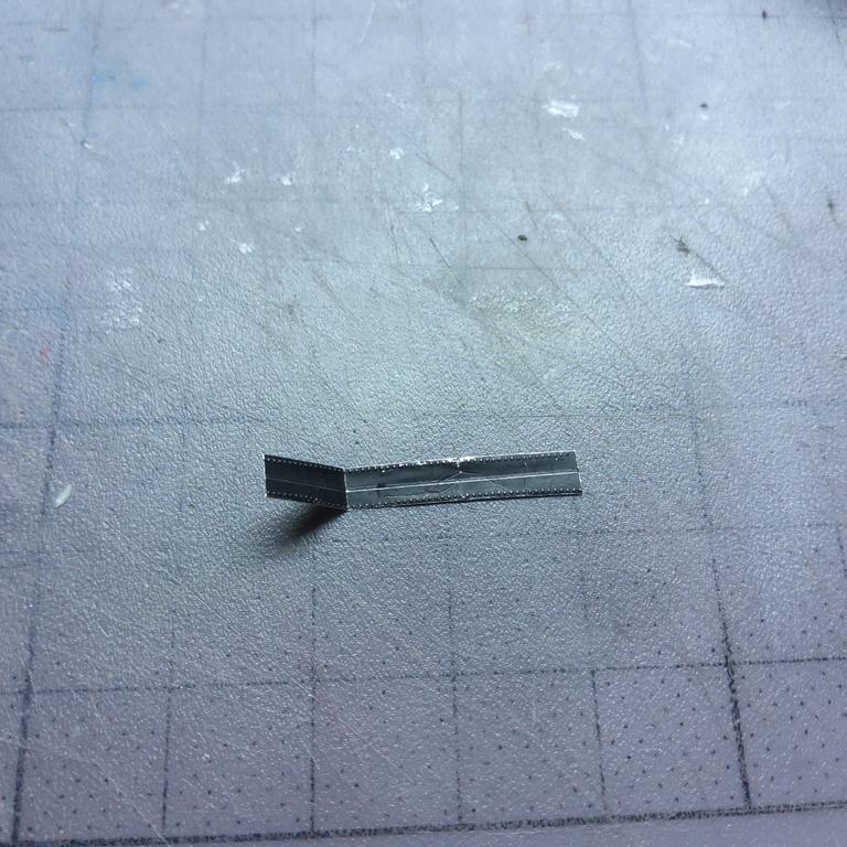

Thanks for your message...and critiques must be used to improve if they are said in proper way and with the idea to help/teach something...If they are just "your model looks like shit, or there is a rivet missing under the panel on the lower cowling, so your model is crap..." those are useless and boring... on the compliment side...if you just recieve all the time "your model is beautiful" ( and there are some evident errors or missing parts) that is not helping...
For the canvas protection I will use maybe blak aluminium foil.... :hmm: :hmm:

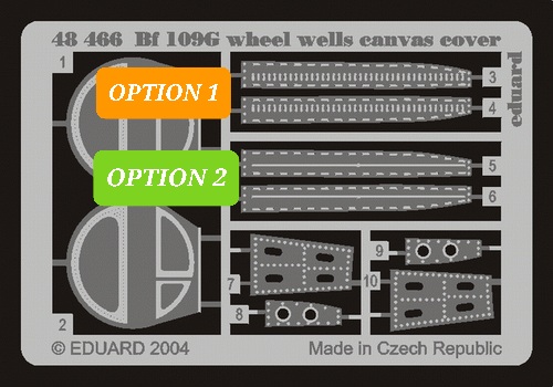

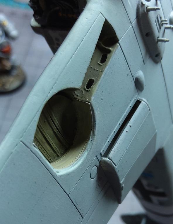

For the covers i can choose option 1 or option 2 or I have to do them both?
Re: Messerschmitt bf109 G10

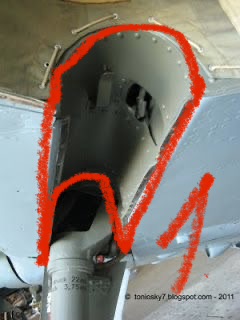

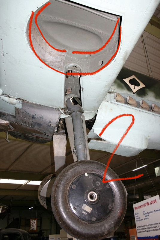

Ahhh! I knew this would be a potential confusion. There are two covers per strut. I’m going to try to find a diagram of the lower wing to show you.
Basically 1 and 2 as you indicate form a pair that covers the openings. I have to send a diagram!
Let me know if this helps.

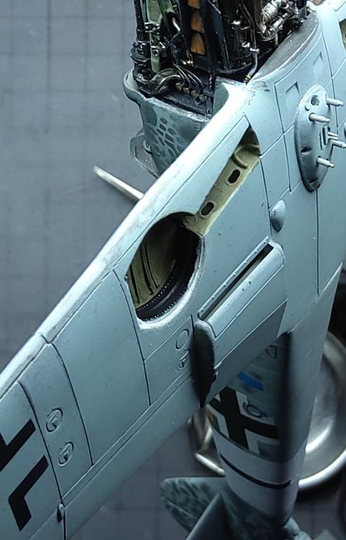

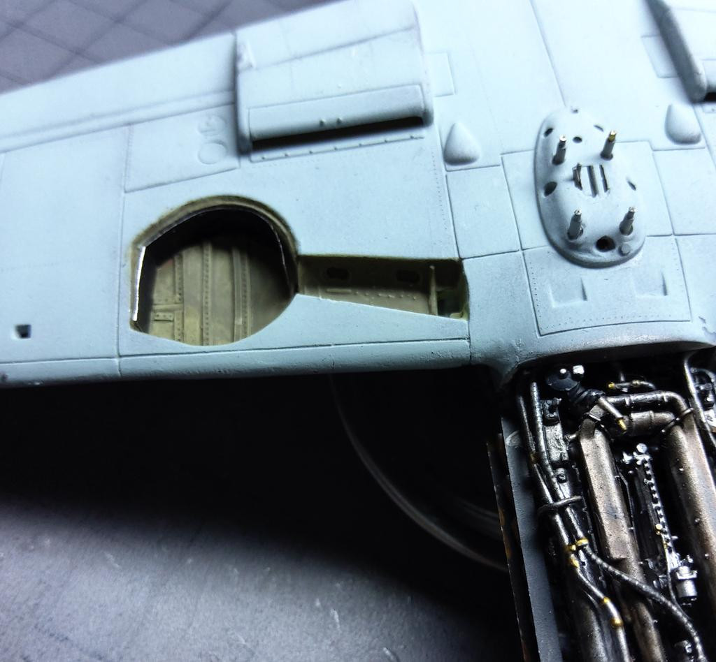

Dear all, thanks to Bruce :bow: and your advices :bow: ...here is today's update on the Aircraft...
Enjoy :grin: :grin:

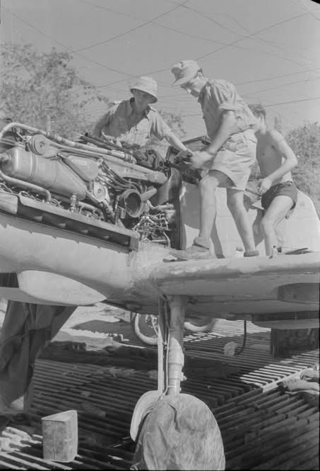

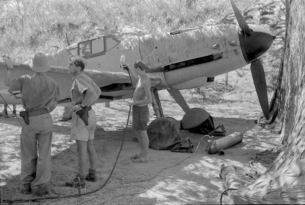

As a bit of a bonus, here are some quite interesting photos of a recon G-8 being painted in the field!
You’re doing amazing work, Greg.
Looks like they repainted the wheel wells, gear struts, and inner face of the gear doors in the underside color. It is an exact match for the surrounding external surface…. :hmm:
I don't see them pre-shading the panel lines :giggles: :giggles: :giggles:
