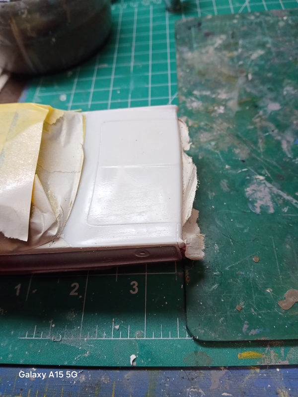

Nice work on the chassis and coach work, Tom! I’d be tempted to dip and strip the whole exterior piece, just take it down far enough and redo it. I know that’s the nuclear option. I’d be slightly concerned about sanding at this stage, though.

The reason I dont want to go that route is I have very little left of Model Master Guards Red and the blue.
I have a plan to fix the trunk top surface.

Of course, Tom! Forgive me. It’s a pity so many wonderful Testors colors are gone now. I think I can match the red but I have no idea about the blue.
The trick will be in the masking. One thing I would definitely consider is “de-tacking” the Tamiya tape to avoid more peeling. Another recommendation is to avoid keeping tape on any surface for too long; I usually tape then paint then remove. You probably do too, since you build so fast!

Detacking tape only result in paint bleeds. My go-ro masking tape has been Frog Yellow painter tape. I also have Frog green painter tape I don't use too often. Probably because its a thicker tape than the yellow type.

Finished removing the problem botched white paint job from the trunk area. Used those green Scotch-Brite pads cut in small squares dipped in lacquer thinner. Worked on a little section at a time getting it down to bare plastic. I say it came out better than I thought. I will go over it with a little alcohol prior to another coat of paint.
