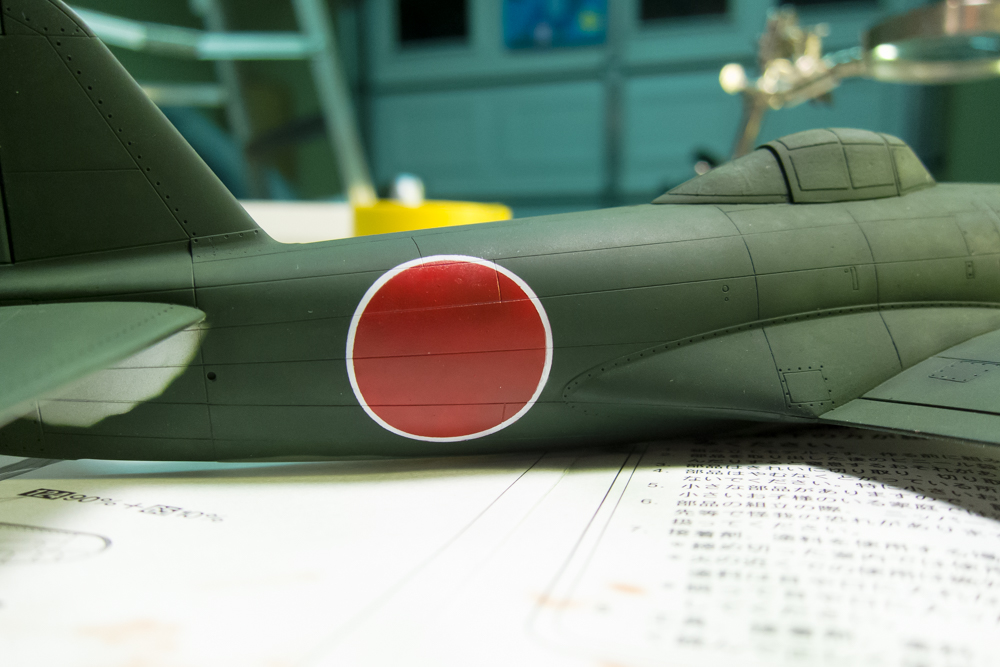

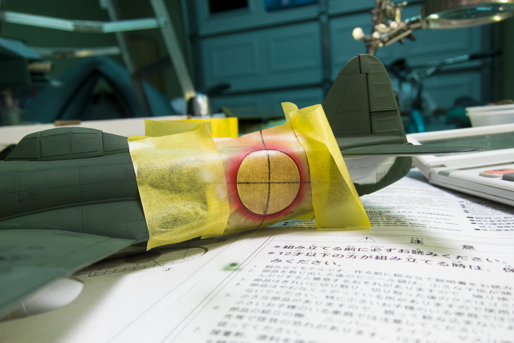

There are different ways you can do this. Prior to getting a Silhouette cutter, I cut masks for the inner and outer circles using a compass cutter. I drew guidelines running through the center of the circles with pen to help line up the masks later on.
First, I applied the larger circle mask(outer) and painted the red.
After the red paint dried, I applied the smaller circle mask (inner) and used the guidelines to help center the mask. The original mask is kept in place. The white outline is then sprayed.
With a Silhouette cutter, the masks would be easier to produce but I would use the same order presented here.
