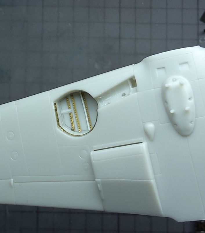

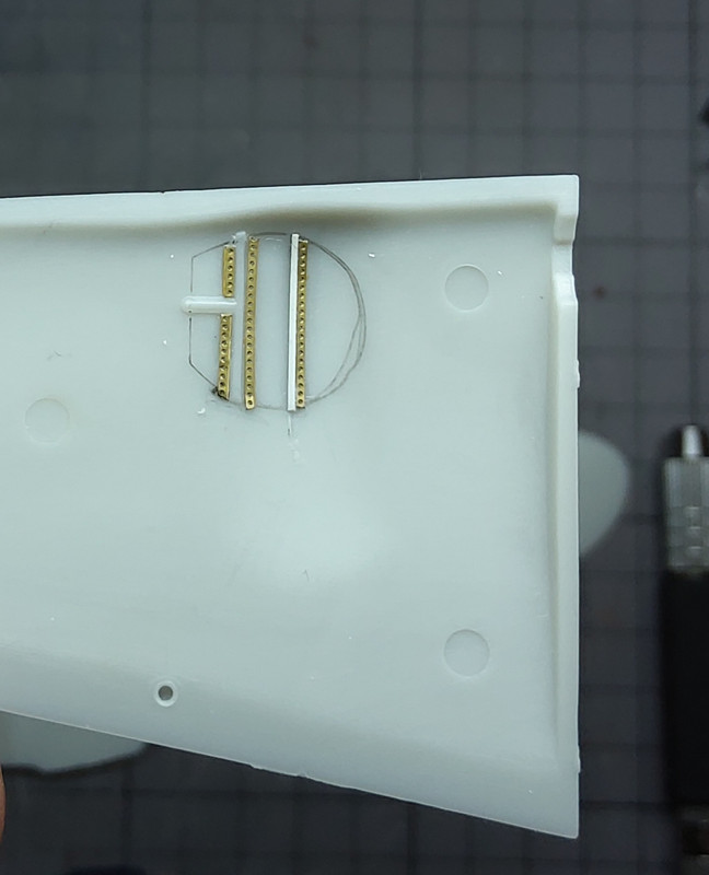

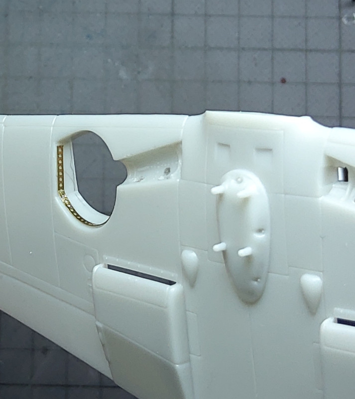

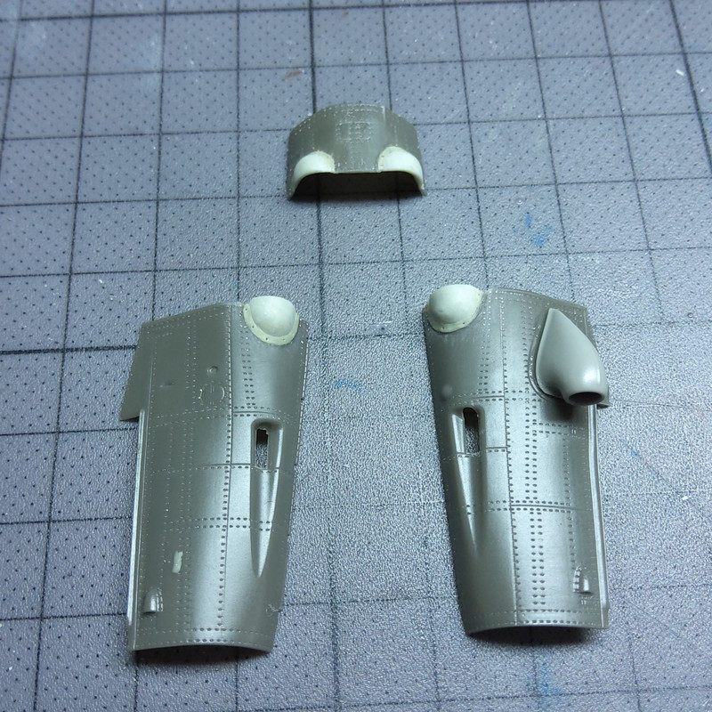

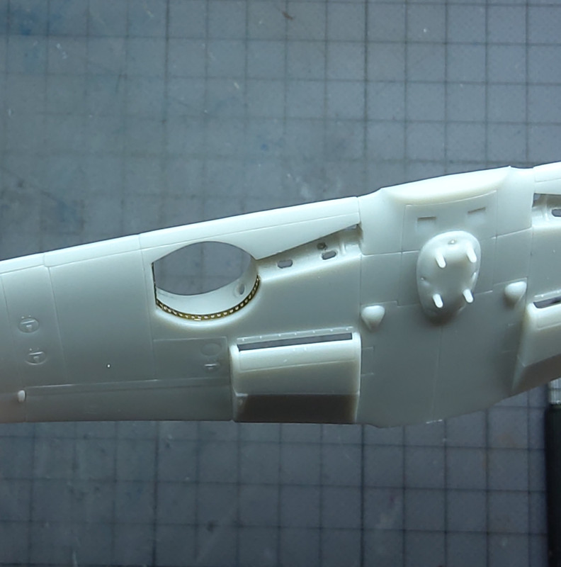

Dear all here is today's update on the Aircraft.
I just finished the "blisters" and added some rivets
Then I started the landing gears bay. Enjoy

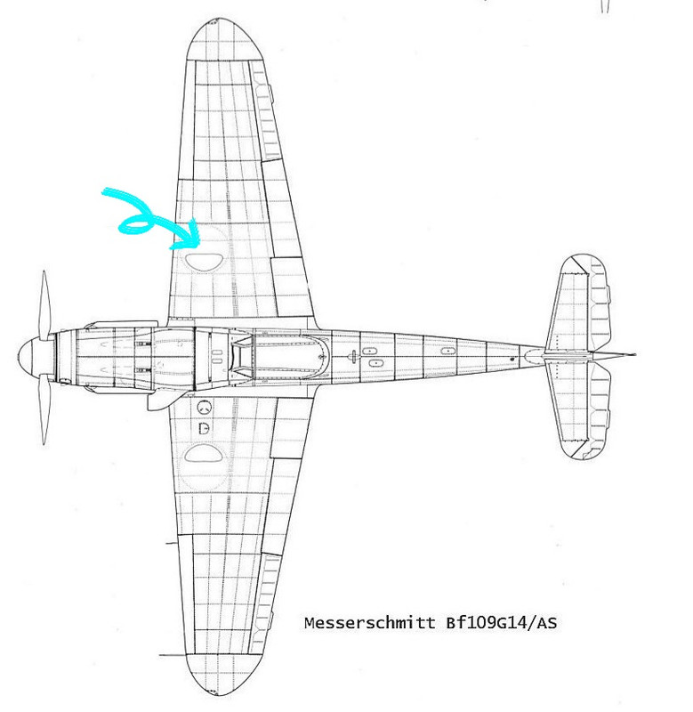

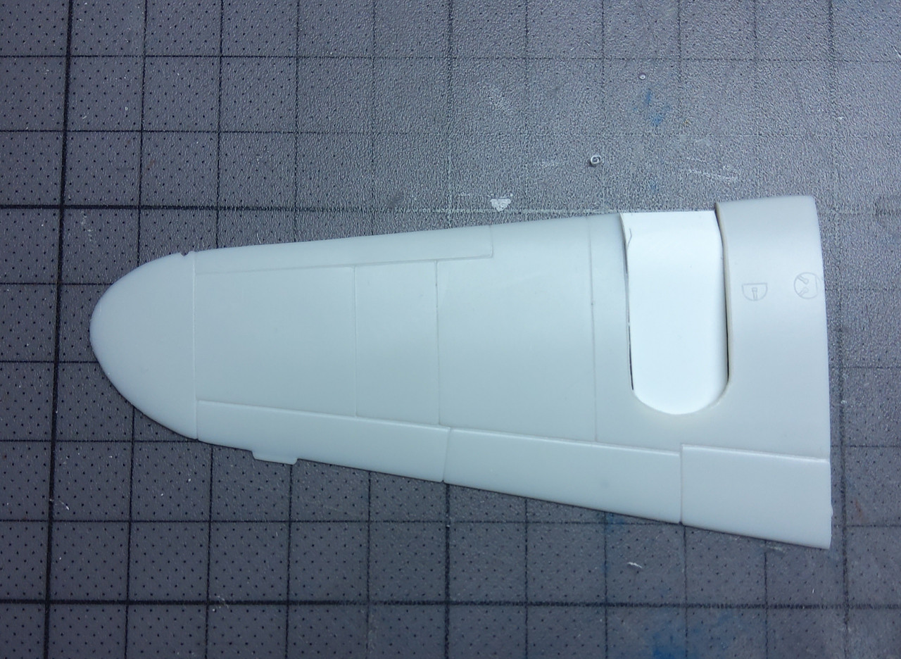

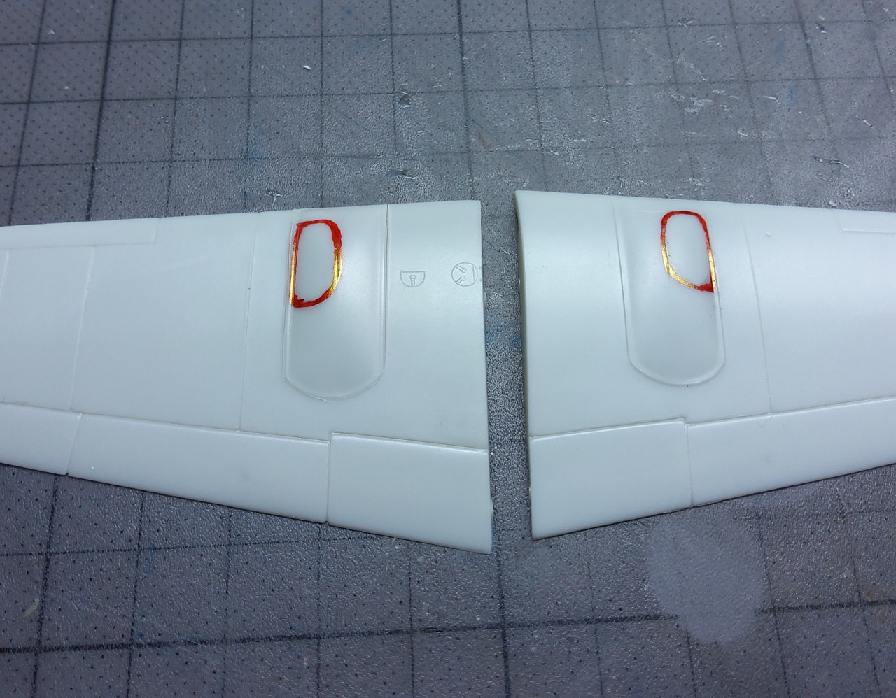

Re: Messerschmitt bf109 G10

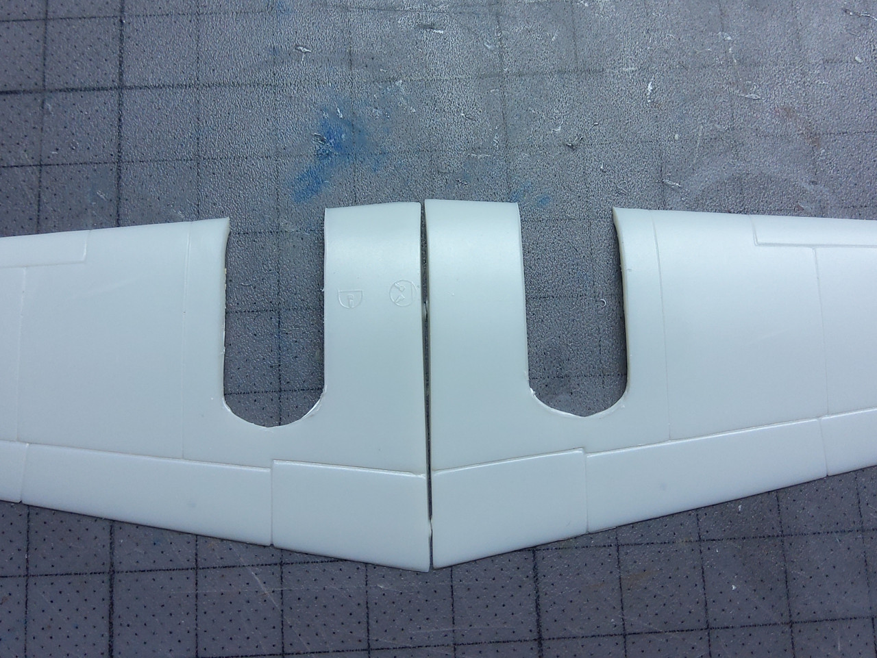

Since I’m representing Blaue 7 from Jagdgeschwader 3, which was a G-14, l had to make some corrections on the kit.
You saw the "blisters " on the cowlings and now I have to correct the upper wings.
Here you can see the 2 bulge section that I have to do...
So I decided to remove the all section and scratchbuilt everything...
And check here the blueprints

Large wheel bulges swapped for the small wheel bulges…
I know...the Joy of going from G10 to G14
