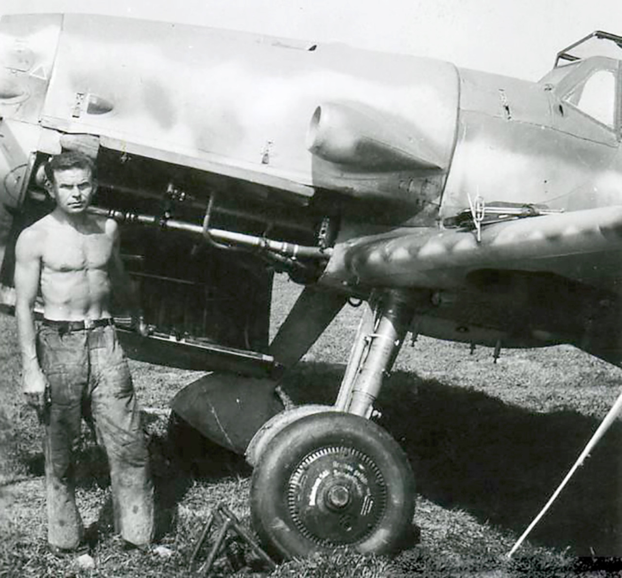

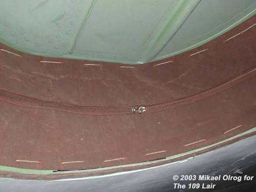

As far as adding canvas covers—apparently there were two covers per side, with one wrapping around the wheel well and the other covering the interior of the strut bay—and as far as I know about production availability these covers were included with all aircraft through the K. I think with the K things were about as far off the rails as production could be. Still, it has been suggested and not criticized that during the war Germany was at the top of the production line status. How this was achieved would sadly devolve into labor camps. With these thoughts I’m thinking of the rocket program in particular. However I just can’t imagine a necessary component being left off. This is not a Frankenstein subject; this is a late ‘44 production aircraft of a design that was developed and perfected by the extreme usage of war. If it was necessary it would be present.
I’ve added a few photos. One is a G-10 with the canvas present but very hard to see. The metal ties look unpainted on the strut to my eyes, as well. The other is a close up of a modern interpretation by a museum and quite a nice color photo of yet another G-series (G-6?) being refueled which gives another interpretation of the interior of the landing gear cover which here looks quite grey… blue.
