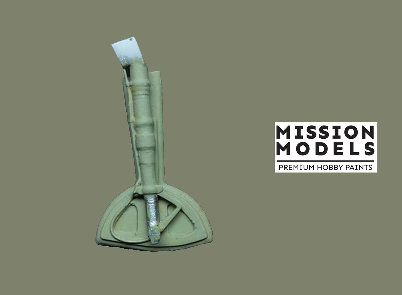

Greg,

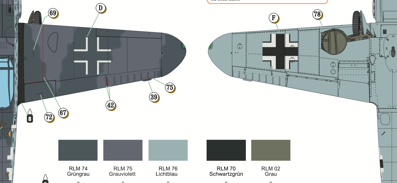

Your work is superlative but I don’t see this as being the right color. Way too green in effect. I’ve added the ZM G-14 color guide as well as created a composite of your color against a color chip to show the difference here.
Again, with so much attentive detail so far to see these legs in this color is difficult, to a degree. I’ve always considered German aircraft colors to be all done in shades of grey to an extent.
Bruce

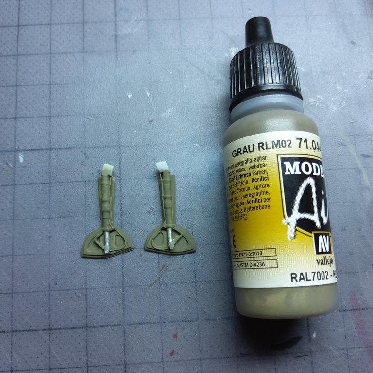

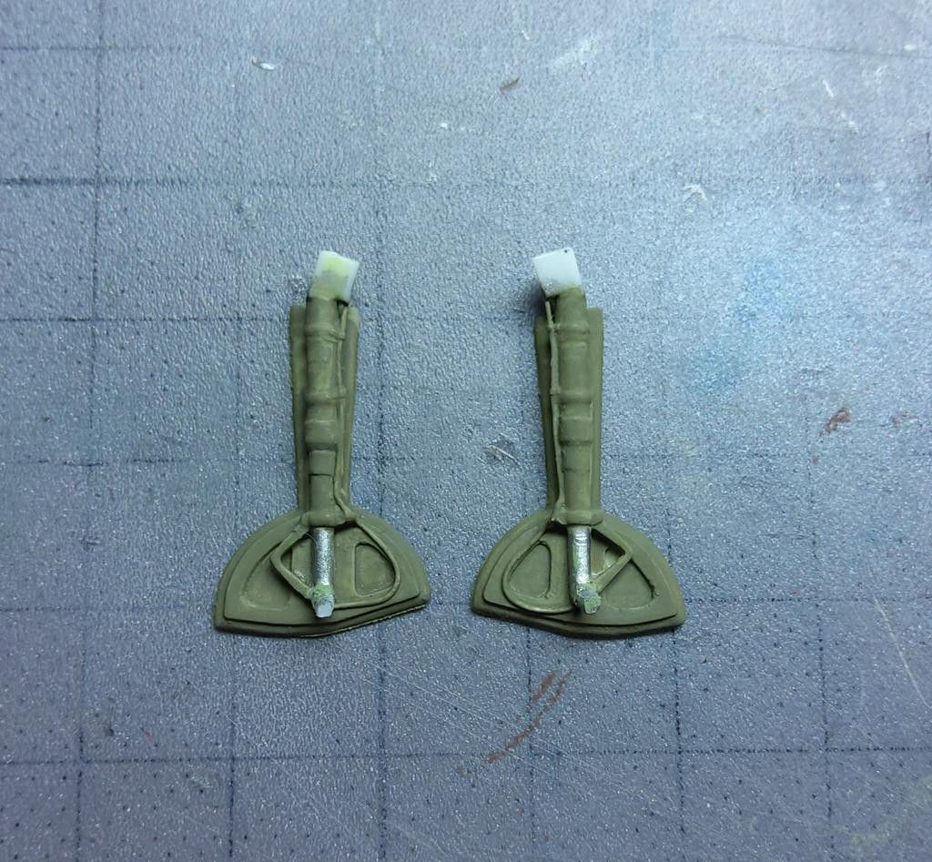

Dear all..since I had to correct :headbang: the color of the landing gears...I looked for a look-a-like...and guess what :whistle: ....(either Lucky :headslap: or dumass memory)....I found it... :yahoo:
RLM02....So enjoy the correction.. :grin:
Re: Messerschmitt bf109 G10
Greg,
We’ve all been there with forgetting bottles since there are so many options. I personally use Mr Color for 02, but Vallejo Model Air is good (my experience being their WWII US color sets) I have a preference for the smoothness and layering qualities of Mr Color. Your new color appears better. I’m sure you’ll remove the hair that is on the left side piece.

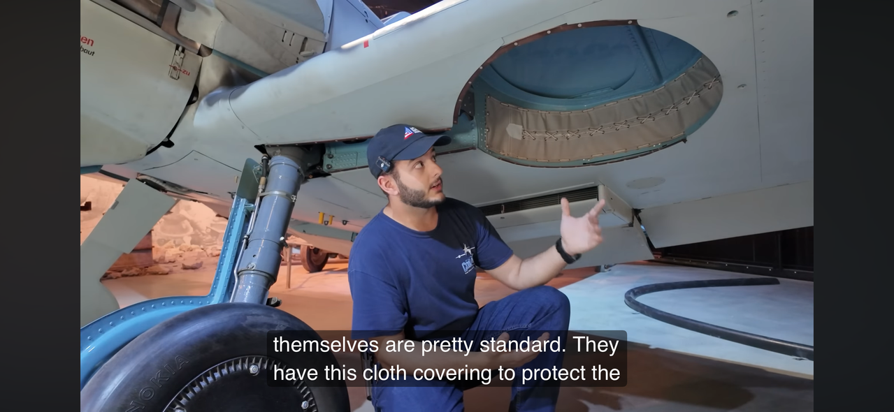

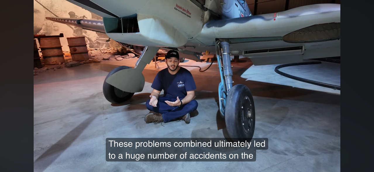

I pulled the still frames to a G-14 walkaround, not for the paint scheme but for the detailing of the gear strut assemblies. I don’t think every hose would be painted green as you have done if these are rubber and metal tubing with clamps (see images). The strut would be painted first than the cabling would be attached. Plus, this G-14 does have the holes inside the wheel wells for canvas covers; I’ve read that these covers were not practical in the field but the aircraft in every series had them.
The link is available on YouTube but I’m always at odds despite help to how I would post it here. American Heritage Museum walk-around G-14 is how I found it.

I stripped the paint :headbang: and repaint them both of course the hoses will metal and rubber where they should be...for the canvas...well :headslap: ..thank you for the extra work... :tongue: :tongue:
