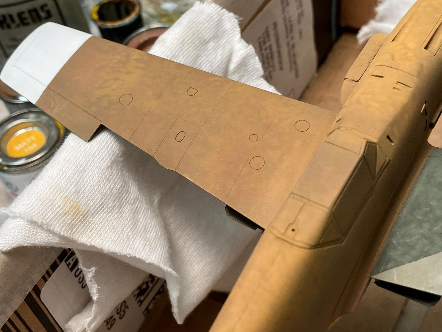

Carlos, before I sprayed Future for a glosscoat, this was the effect I had:
After the gloss was sprayed, so much of the faded look was obscured. I was disappointed and hoped that a good matte coat would bring it back. It did help, but it still looks shinier than I want. I'm hoping to try that Humbrol over it next, but I will definitely try it on the paint mule first.

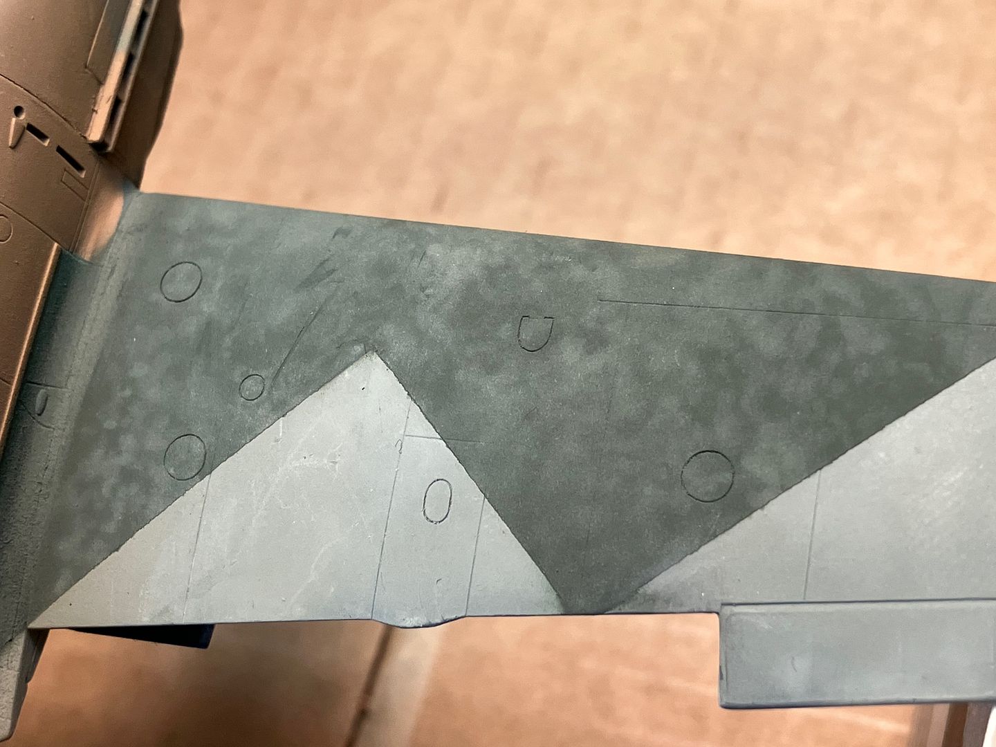

Here, you can see what I mean; not as much contrast left between those carefully "faded" colors:
